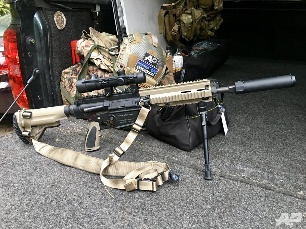

I did think I had more photos to share, but apparently I was focused on the build, not sharing. Here is a photo of the completed project, it is a beast and shoots very well.
20885
The large buffer tube allowed me to install a Gate Airsoft WARFET and still gives me room for a 1000mAh 11.1 Turnigy Lipo to slide right next to it. I had planned to install a BTC Spectre, but the gearbox this is a V2.2 :x Note to self - "Make sure you know what your getting into when upgrading" In all fairness I have been airsmithing as a hobby for many years, but do not have the broad experience a Airsoft Bench Airsmith at a shop would have.

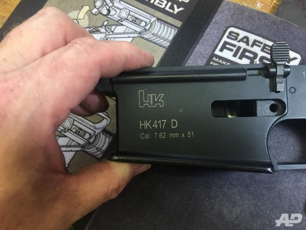

I did pick up this AEG at a very fair price from a airsoft friend at Summer Slaughter. It was gently used and came with 3 midcap mags. This was the perfect start to a DMR platform. I wish I had more photo's, sorry, here is the lower, no paint. The rest was already disassembled and going into the media blasting cabinet.
20859

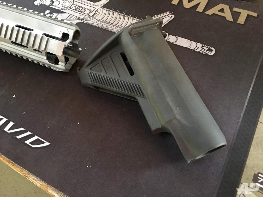

OK here is the stock and rail, before 8)
20860

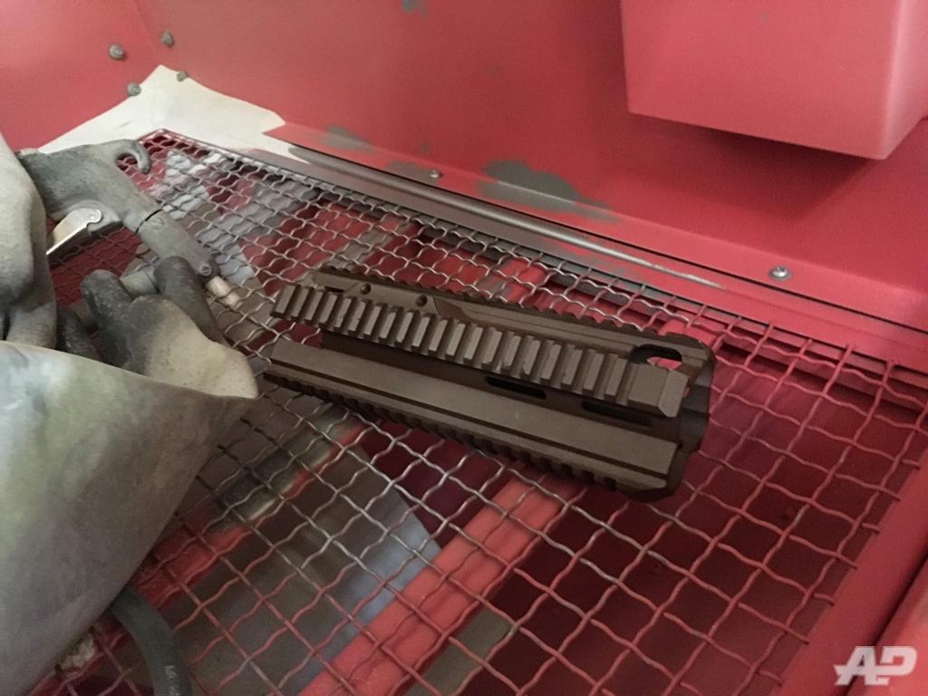

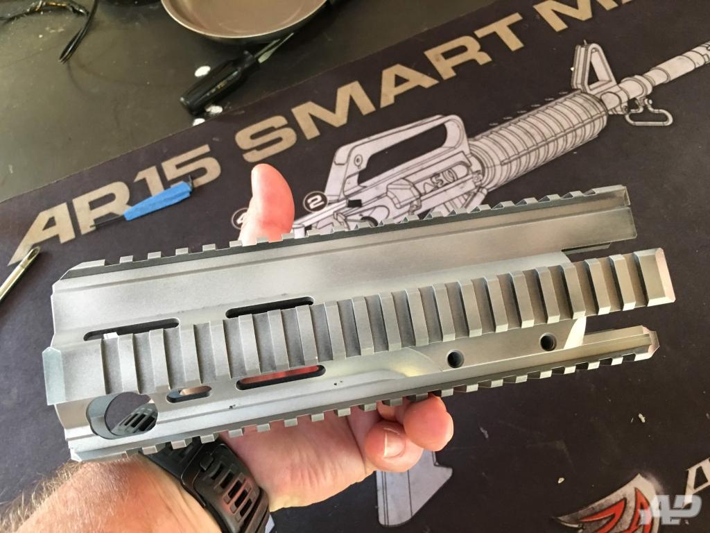

Into the media blasting cabinet. This is glass bead, not sand.
20861
http://airsoftpacific.com/gallery/image.php?album_id=1171&image_id=20861

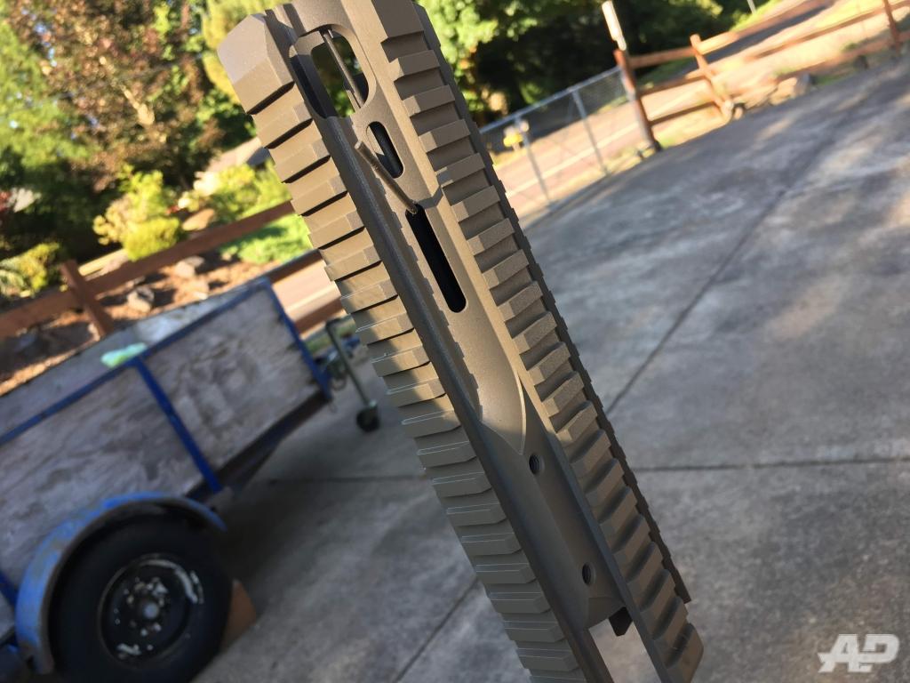

Rail is done, not perfect, but my new Favorite paint does not require it.

Here is the rail

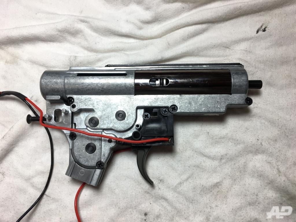

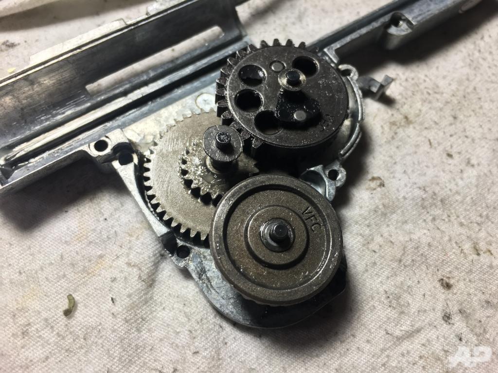

Gearbox time. Here it is out of the AEG, excellent shape ... but needs some work 8)
20871

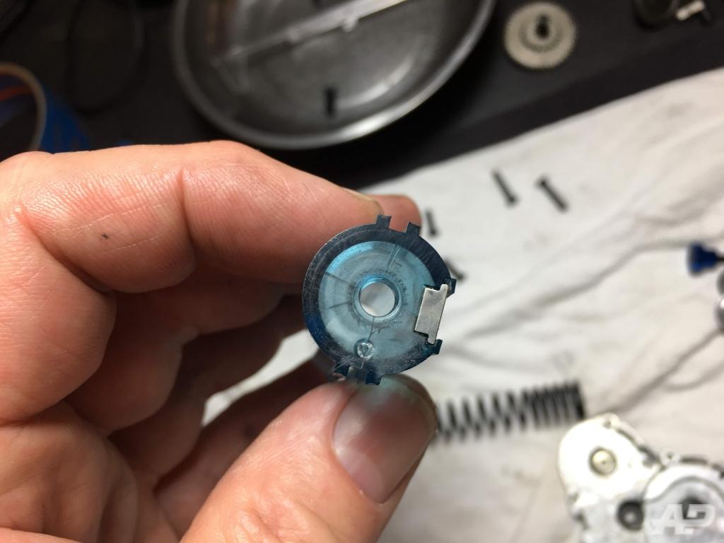

Notice the cracks on the top of the piston? Replacing it was always part of the plan
20872
I like VFC's but not a fan of the self-shimming GB. That gets shimmed :lol:
20874

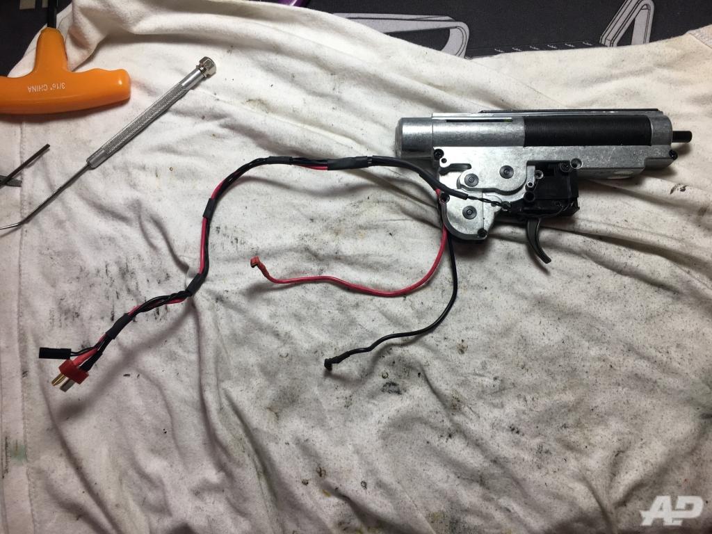

Here is the GB assembled, notice the trigger wires .. yes rewired for the Gate Airsoft WARFET. The 2 trigger wires route up the buffer tube alongside the 2 battery to motor wires.
20876
The buffer tube is huge, I can put the WARFET next to the battery and it fits with room to spare.

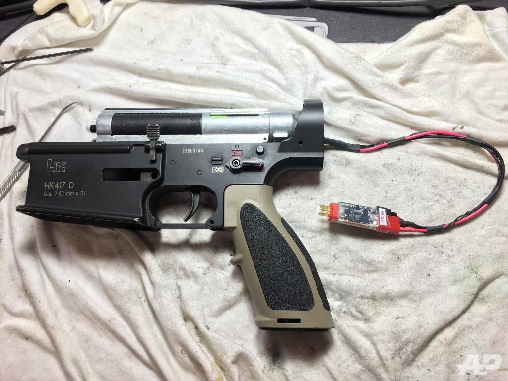

Lower assembly complete
20878
Well almost complete. This a DMR and while the WARFET can be locked to semi only, I wanted a mechanical lockout. Disabled the lower and tapped it for small hex screw, then everything back together.
