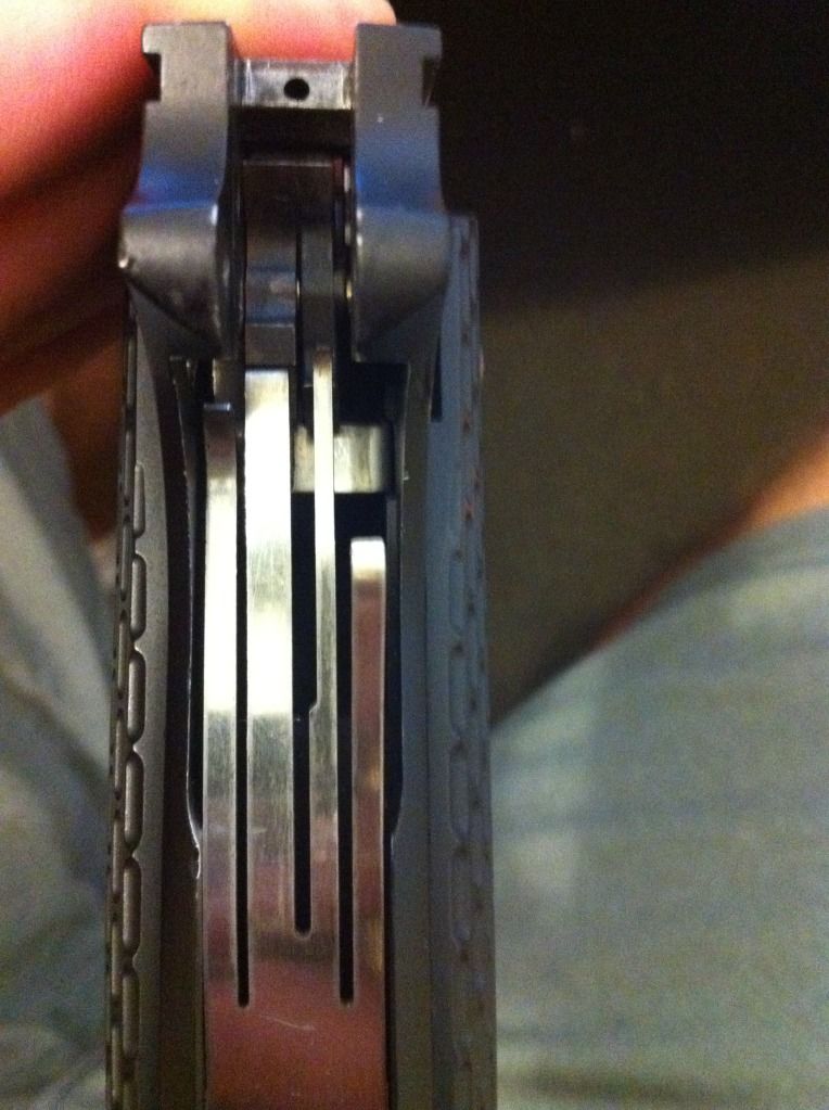

I now know how to get the pin back in, and the entire pistol reassembled. The only problem I am having is that darn leaf spring in the backstrap of the pistol!
If anybody has a picture or video of the proper installment/arrangement of that leaf spring, I would really appreciate it. I found one, but I couldn't see what arrangement the trigger box was in. Those three parts (2 bronze colored, one black) are movable and are proving to be my only hiccup here.

Postby Payback » Thu Dec 06, 2012 8:55 pm
I didn't want to dive into it too deep. But here are the best i could get. Looks like the short silver tab goes to the right side of the gun if it's pointing away from you. The black metal part is either connected to the hammer or at least touches it.

Postby Switchback » Thu Dec 06, 2012 10:48 pm
So somehow, after hours of work, your images were what sparked my success. Pics for heathen non-believers.
Got it firing, and of course it shoots like a dream again.
