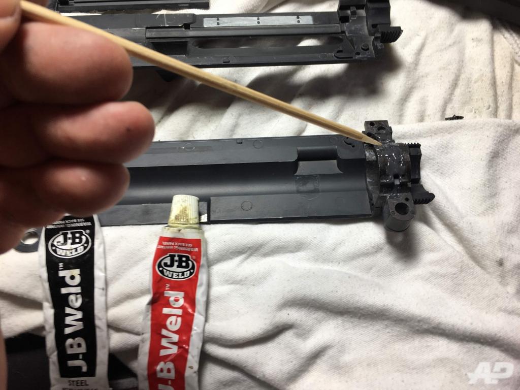

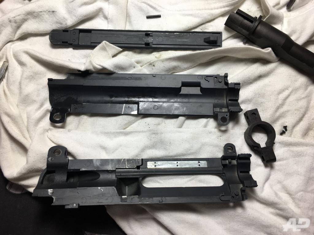

If you are familiar with the old KWAs and those 4 piece (pos) uppers you have experienced the wobble.
You can buy a one piece upper or try my little trick.
20811

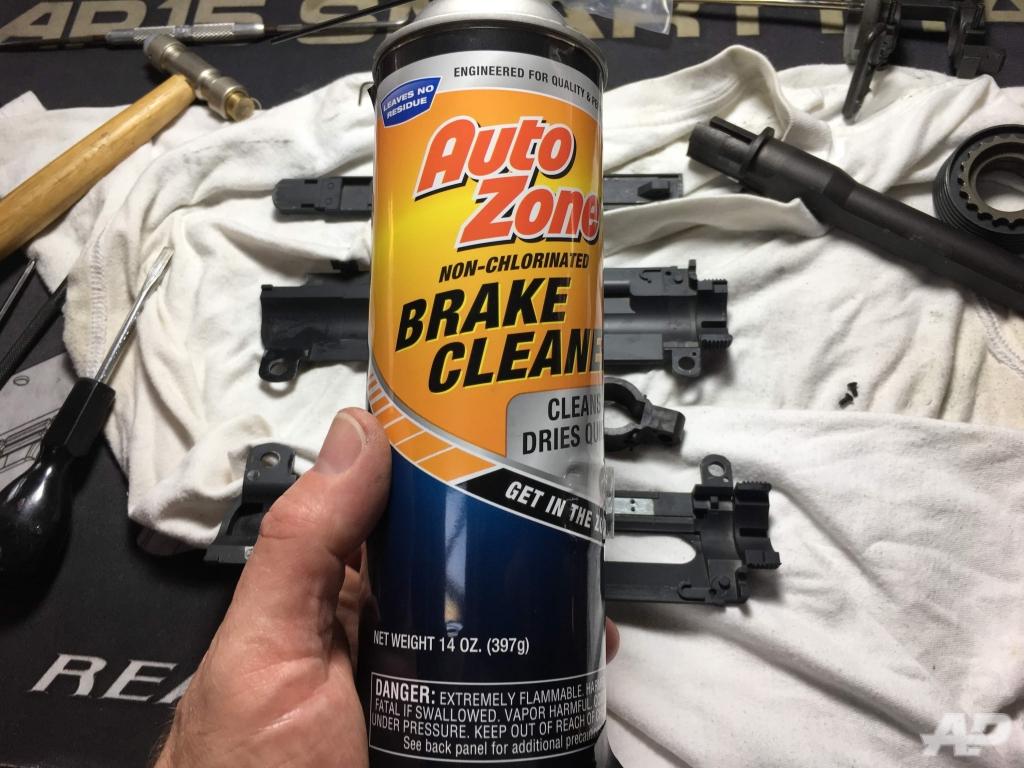

Here is the upper broken down.
20812
Best cleaner for metal parts, don't forget the eye pro

Oh yes, the good old reliable J-B Weld :)
I used this same trick on my LM4 and even with the gas blow-back recoil the upper is solid.
20815

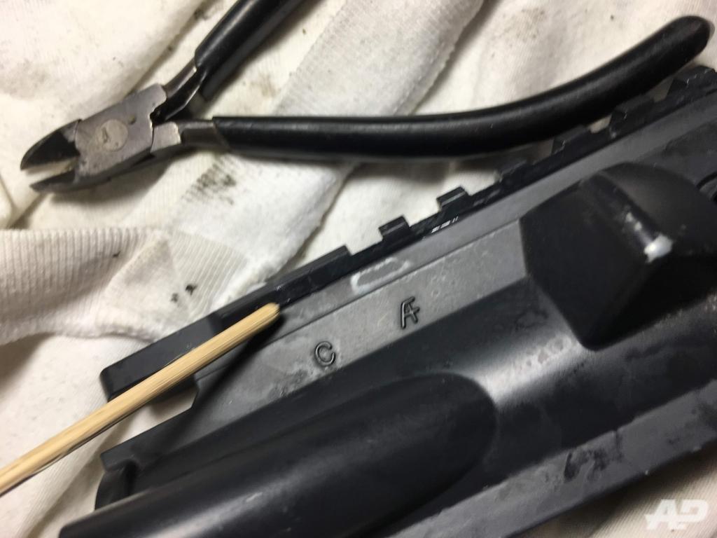

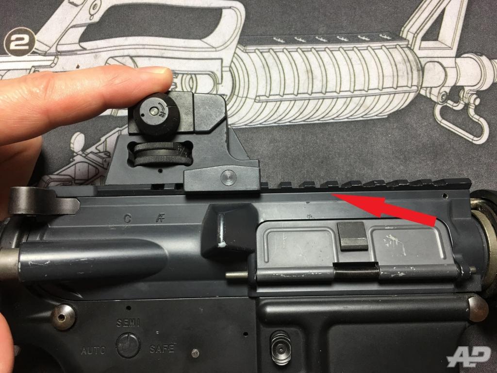

Attaching the Picatinny rail takes some care. Fill the pocket on the rear of the rail and make sure you apply sparingly to the upper where the rail sits
20816
Quickly clean up any J-B that may of squeezed out.
20817

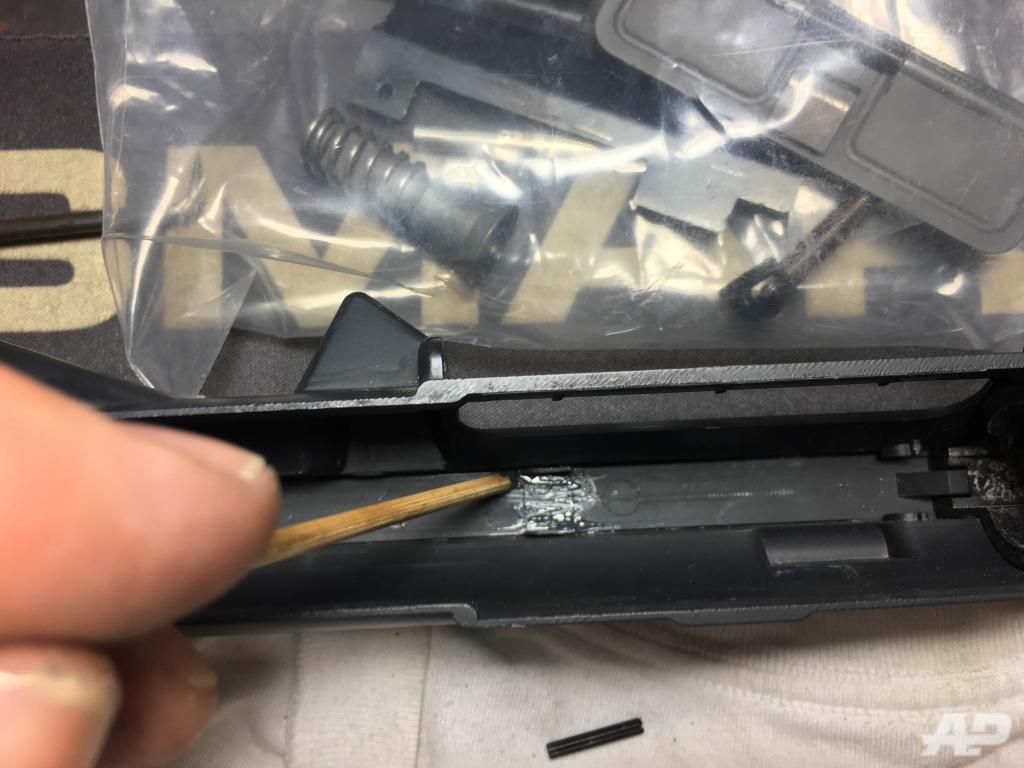

Dont forget the inside of the upper. Any extra J-B will interfere with the charging handle
20818

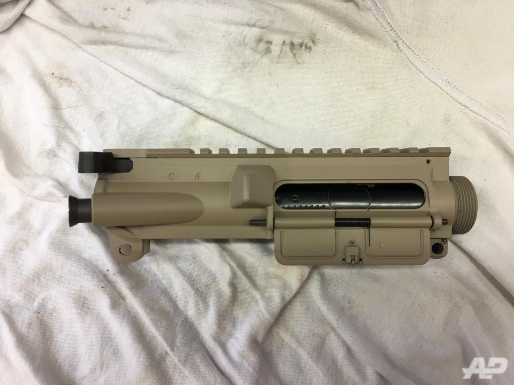

Here is the assembled upper. Wait at least 24 hours before applying paint. This is Krylon Camo Paint (Khaki color). I really like this paint, it is inexpensive, very flat and easy to use. This color is a bit tan and doesn't match the Magpul FDE well, more on that later on.

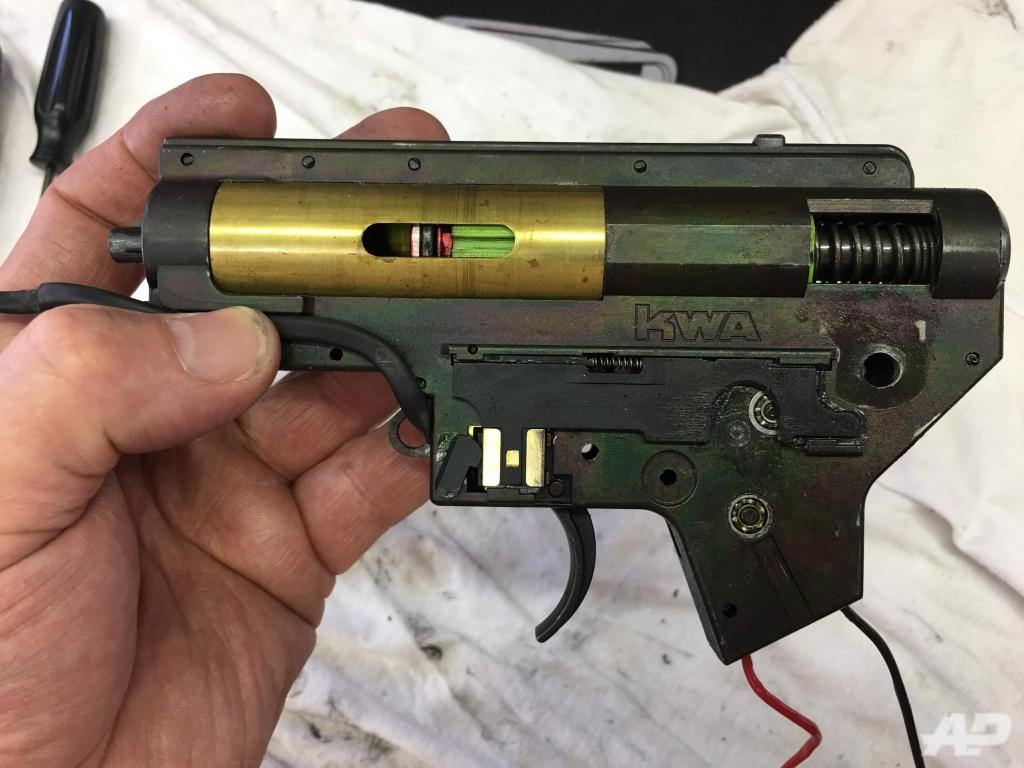

You can see the MOD2 cylinder is ported for a short barrel, thus the new one. This gearbox is front wired, I need it rear wired.
20820

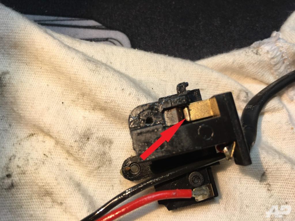

Trigger contacts from the MOD2, I run 11.1 Lipos and mostly semi auto, its havoc on trigger contacts and they deteriorate very quickly. I have a solution I'm pulling from the SR10.
20821

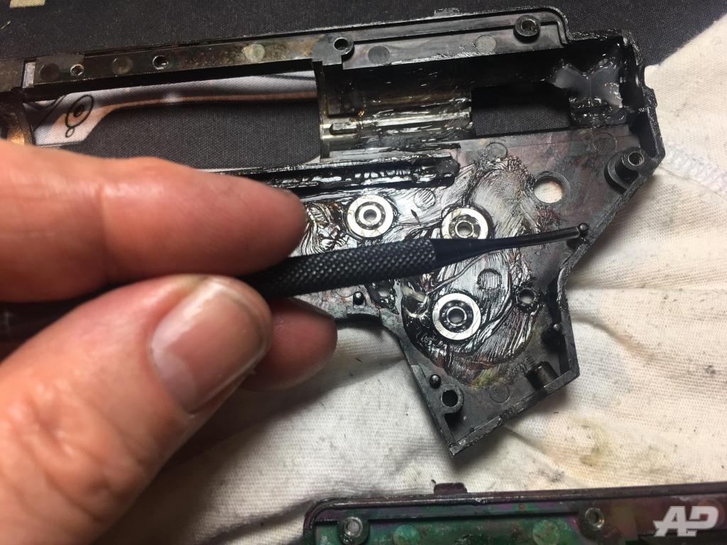

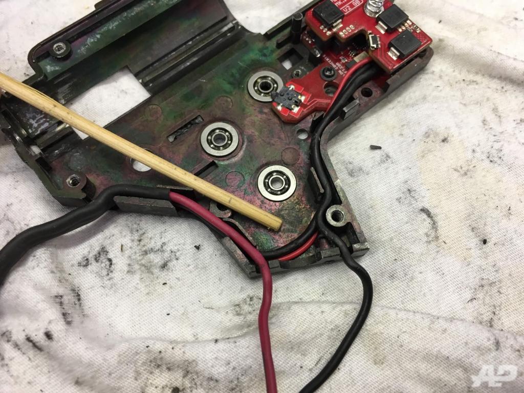

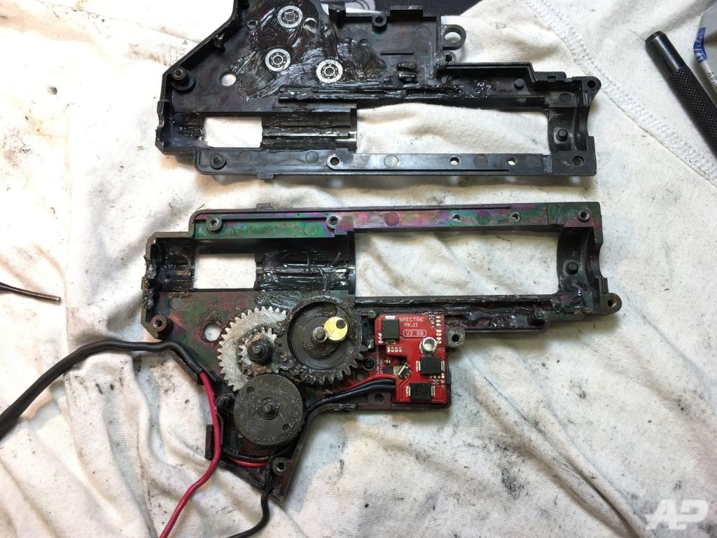

Yes, that's a BTC Spectre installed in its new home. Wire routing is key notice how they are laid out.
20823 20822
After lubing the one side I noticed I forgot to remove the wire hold down pins from the right gearbox side :-X These need to be filed down or they will pinch the larger wires of the BTC.
20824

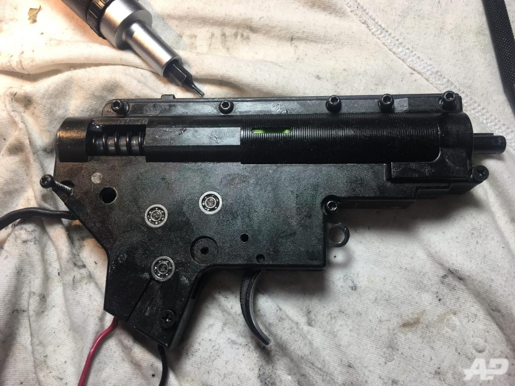

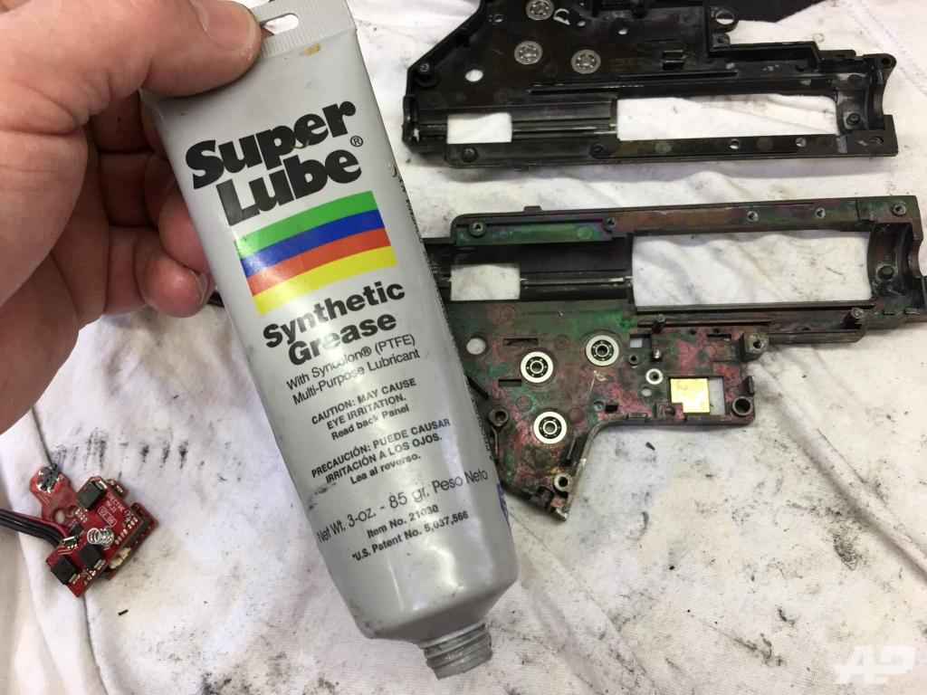

All is good now, BTC and gears installed and box is lubed :-p
20825
The cutoff level and trigger safety lock are deleted when installing a BTC. That's the only thing I don't like about the BTC. When your AEG is in safe the trigger can still be pulled. I wont fire, just something to get used to.

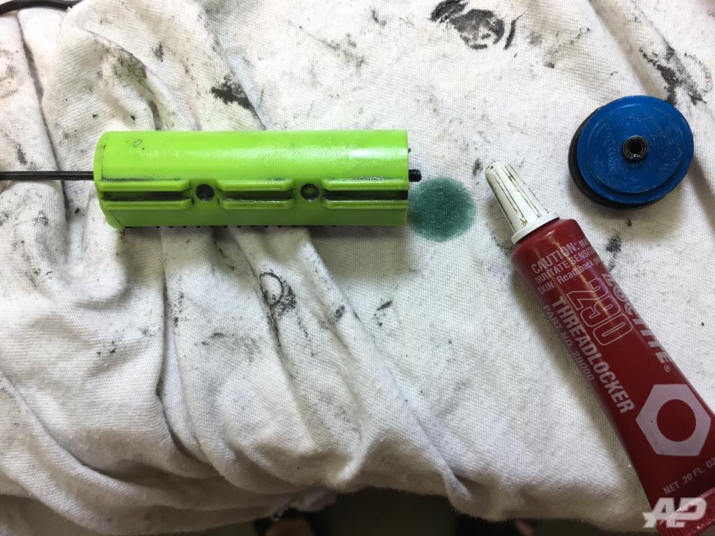

Here is a closeup of the GB internal parts. I'm going to reuse the Madbull PX-02 piston that was in the MOD2. My SR10 had have the same piston in for 7 years, 100Ks of BB fired.
20827
Don't forget the loctite on the piston head screw.

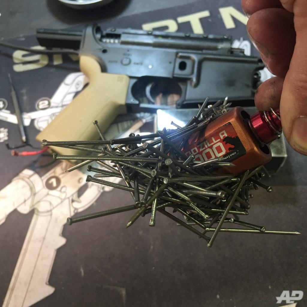

Ok, another fav part is the Godzilla 5000 motor, why? It's one powerful little spinner. You can see the PTS grip installed in the background.

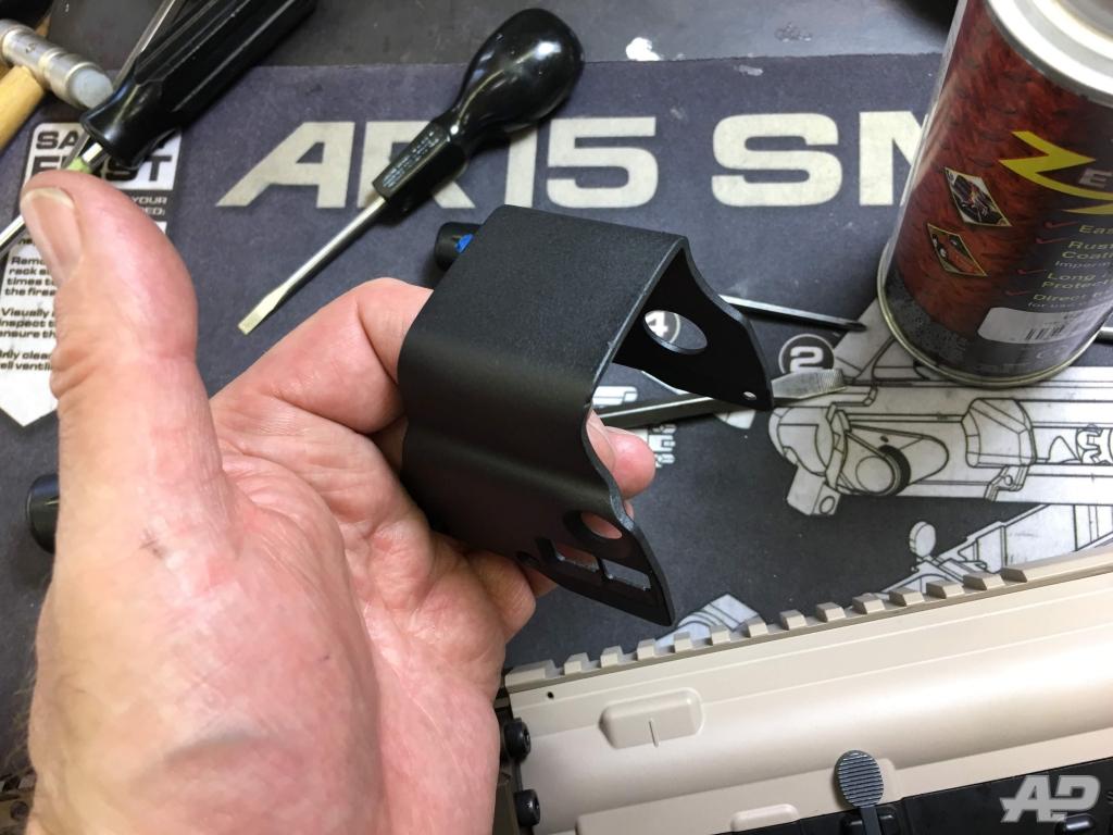

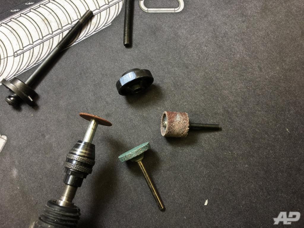

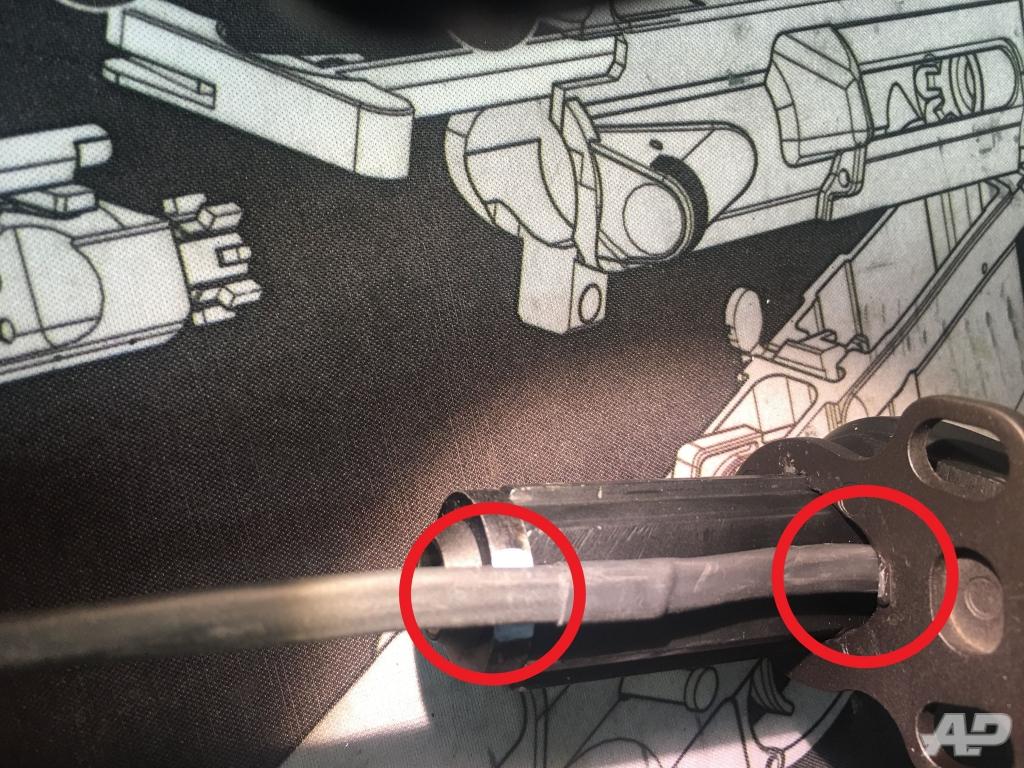

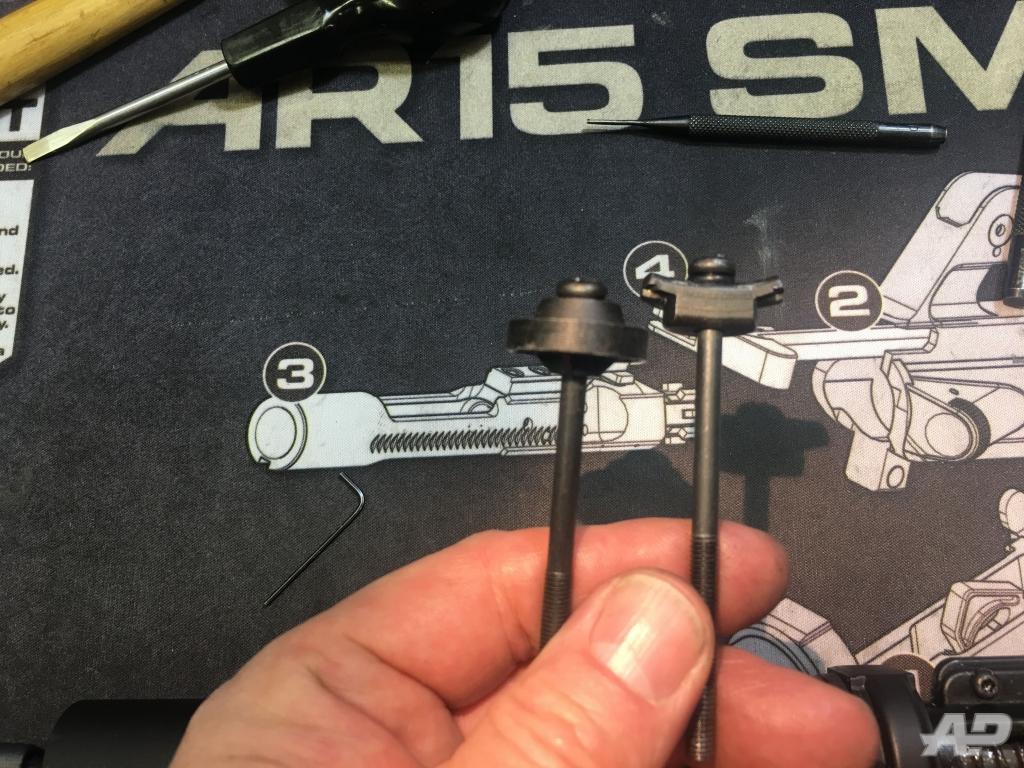

Ok, remember I need to convert to a rear wire, the GB is complete, now the buffer-tube. I was going the use the buffer-tube screw and retainer from the SR10 (on the right) looks a bit tweaked to me.
20833
I temporarily installed the retainer and marked it (left circle, notice the white under the wire) The right circle shows where you may nee to remove some metal from the sling plate so it wont pinch the wire.
20835 20834
Here is the retainer with the newly added notch for the wire. The right tools make this easy.
20836

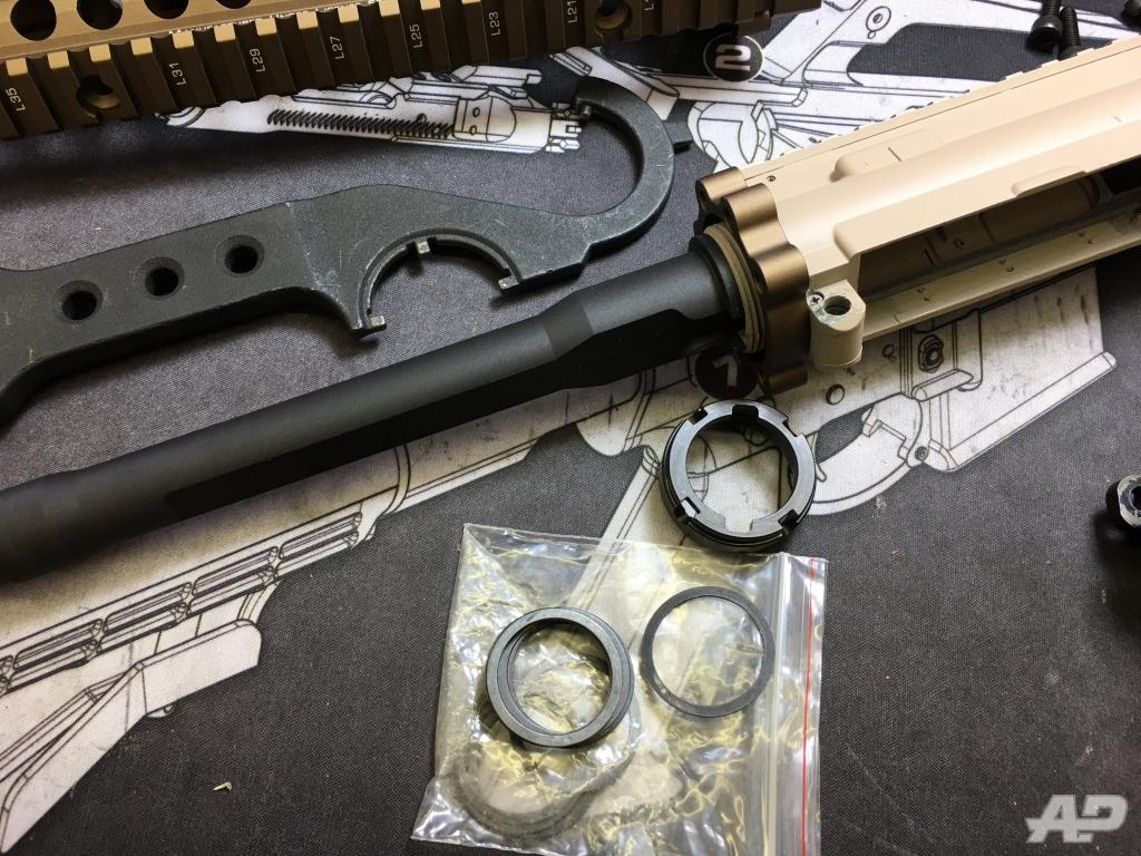

OK, now time for that sexy Danial Defense rail 8)
20837
Shims may be needed to hold the barrel securely. BTW this outer barrel is from the MOD2.
20838

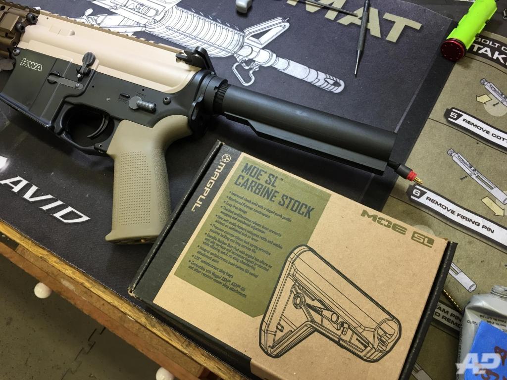

Now the most difficult part :wink: installing the stock.
20841
Almost there ... :-D
20842

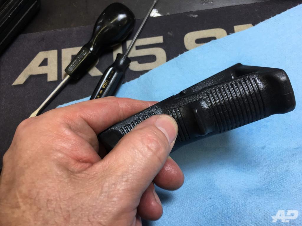

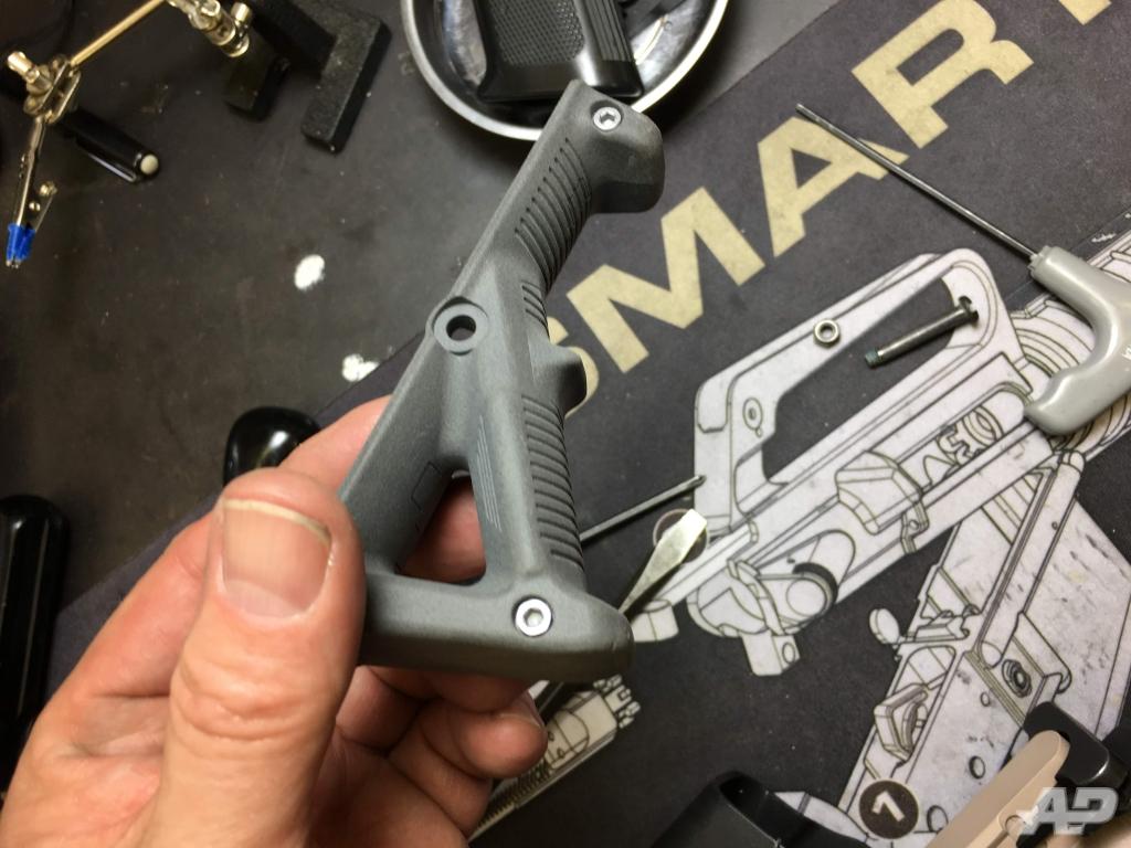

Nice grips are expensive, and everyone has their favorite. Here is mine, unfortunately its from the SR10 and painted to match
How to remove paint ... yes I'm lucky I have a sandblasting cabinet. First attempt on plastic, I normally reserve this "glassbead" media for Aluminum or Magnesium, that's another story.
This worked very well and you dont' need a cabinet, you can do this outside.
20843
the grip is all cleaned, but looks a bit weird.
20844

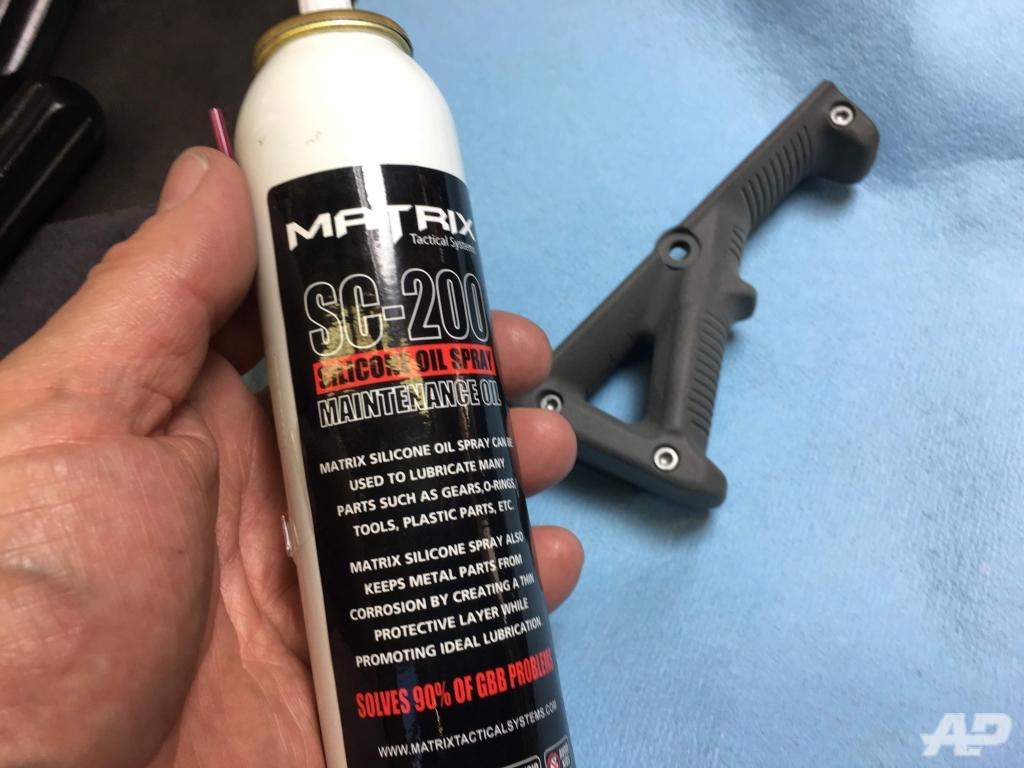

Lets try a bit of silicone to bring back the orgional black color.
20845
Light sprays and a little RUBBING :rockon: bring the color back.

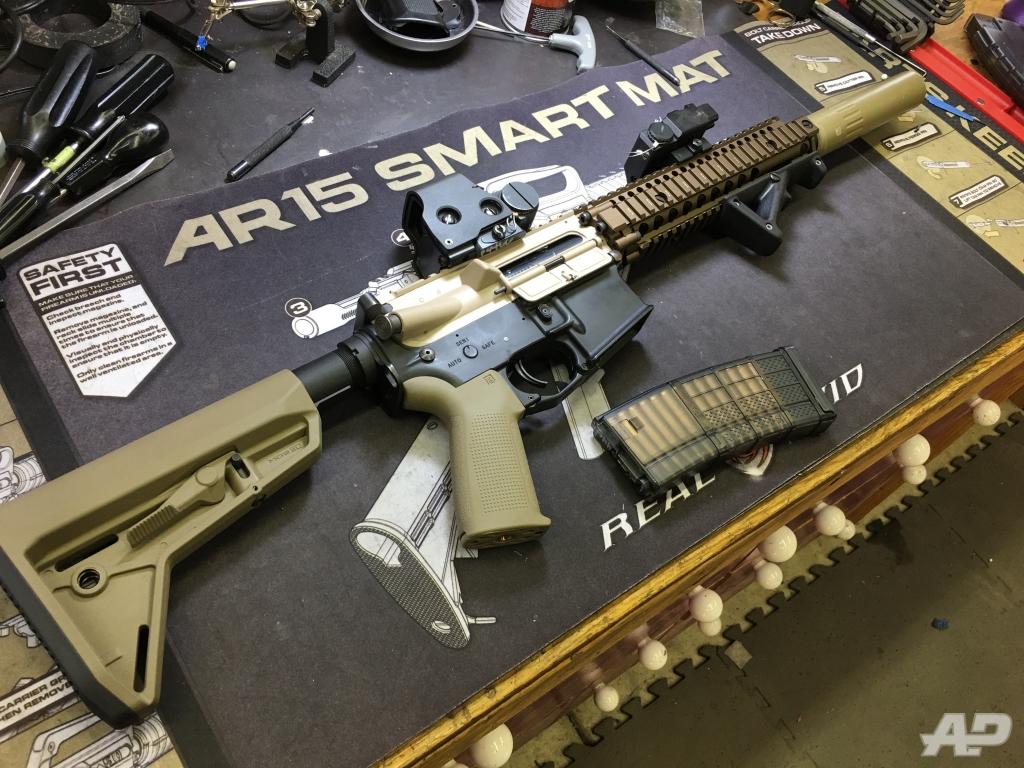

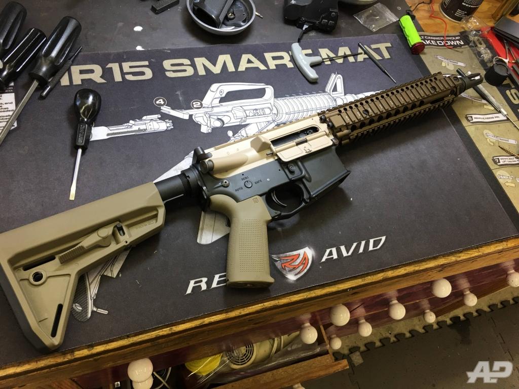

All assembled with optics and a PEQ
I hope you enjoyed this overview. I will be posting a few pictures from my HK417 D build I did, but that will be in another forum.
Eye pro is also important in the shop, 8) Be safe whenever airsmithing.
