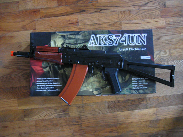

The VFC AKU is a quality replica. Straight out of the box it is as nice as anyone could hope for such an esteemed piece. It is shiny black and has a surprisingly durable finish. The two-piece wooden forend is coated in a clear-red gloss that reminds me of the Chi-Com guns from the 1990s that were soaked in cosmoline.
Airsoft Outlet NW provided this replica, and asked me to make it resemble a battlefield veteran. I planned to strip the finish on the wood, bang it up a little, stain it, and rub in an oil finish. On the metalpieces, I simulated wear and weathering using enamel paints. My intent was for this replica to look like it was lovingly carried and used until the day it was dropped in battle and recovered by a lucky operator.

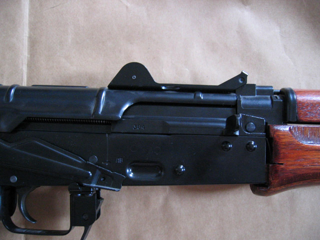

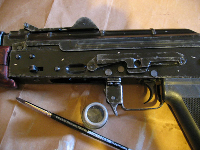

Moving onto the metal, I wanted to replicate light wear on all of the raised surfaces. To do so I used a dry-brushing technique. I prefer Model Master enamels as it is some of the best available and wears extremely well. My palette consists of "Chrome," "Steel," and "Aluminum." Mostly I brush an area with one of the colors, and then add a highlight or two with one of the other colors. To dry-brush correctly (it takes practice, trust me) you must load your brush with paint, and then remove 98% of it. Lightly brush the desired areas with the brush. The raised areas will pick up the paint. This is a task which requires patience and concentration. A little goes a long way, so be careful. I like using the chrome-silver and a tiny 5/0 brush to add some fresh dings and highlighted areas. It is almost indiscernible until you get the whole thing in the sun.
All said and done I spent roughly nine hours detailing this replica. Most of that time was spent waiting for paint to dry, but I consider it time well spent. This replica looks to me like it was well-used up until the time it was dropped in the sand somewhere on the banks of the Tigris.
