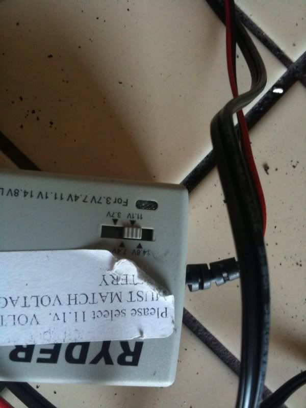

The charger should tell you how many amps you are charging at rather than volts. You want to charge at a 1c rate, never higher unless the battery says you can do so. A 1c rate means 1 times the capacity. So for a 2000mah battery, you would charge it at 2 amps, no more. Being that this was an 1800mah battery, you should be charging it at 1.8 amps. Here is some info from a lipo website about charging these types of batteries:
You must select the charge rate current that does not exceed 1C (one time the capacity of the battery, unless otherwise noted). A higher setting may cause fire. This chart is calculated at 1x capacity of pack. Generally speaking, charging at even lower rates will extend battery life.
800 mAh: Charge at or below 800mA
1500 mAh: Charge at or below 1.5 Amps
6000 mAh: Charge at or below 6.0 Amps
If at any time you witness a battery starting to balloon or swell up, discontinue the charging process immediately. Disconnect the battery and observe it in a safe place for approximately 15 minutes. Continuing to charge a battery that has begun to swell may result in fire.
So, you mentioned that you charged it at 11.1 volts. Can you clarify this number for informational purposes?

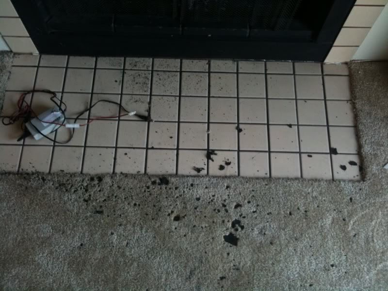

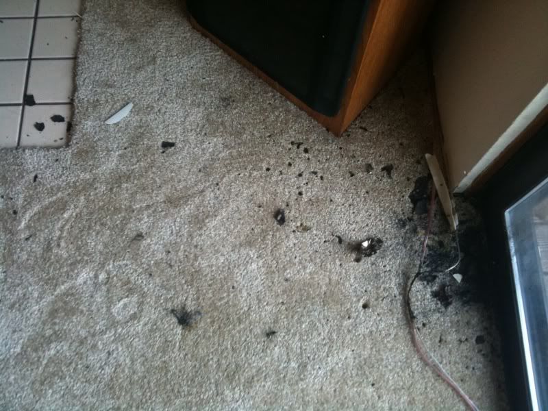

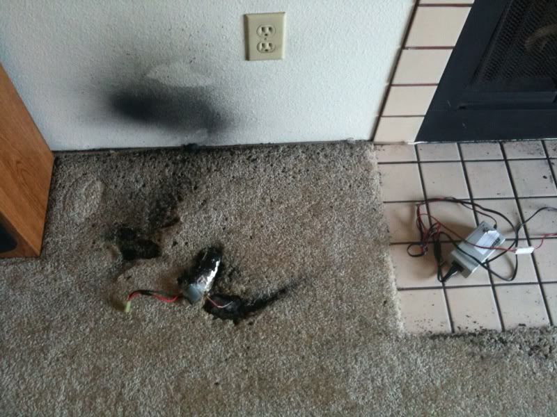

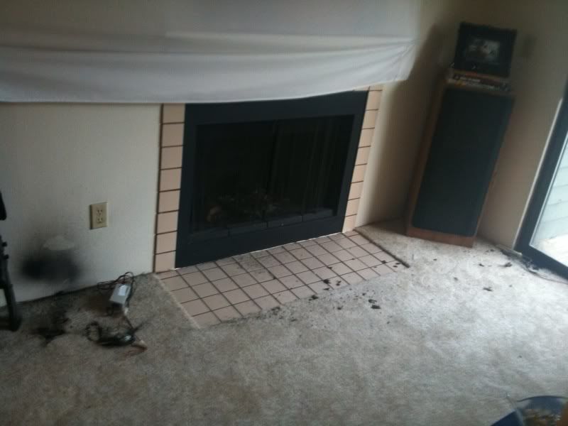

Postby Creature » Tue Mar 23, 2010 11:54 am
Let me clear this up because I can already see it coming, the battery and charger were both located on the tile, the half of the battery that remained tethered by the connector to the charger landed on the carpet under the plug. The other half shot across the room hitting the sliding glass door and falling to the ground. The battery literally exploded and seperated lengthwise into two pieces Every single glob of battery innards was aflame that you see on the carpet. Oh and the white pieces of plastic you see in the second to last pic are the pieces of blinds that shattered when the battery hit the door.

Looks like one of the horrible NON balancing chargers from airsplat.
There's your problem.

Postby Nec » Tue Mar 23, 2010 8:12 pm
Transition, I'm sorry about what happened hopfully you are ok.
BTW Those chargers are horrible!
The switch on the top can easily "bumped" to a different setting which leads to overcharging. My friends has that very same on and has "puffed" 2 lipos, thankfully they didn't explode until after he put them outside and under a Terra cotta flower pot.
You said you only have a single cell to charge? That is very interesting, I would ask for a picture but obviously you don't have that lipo anymore. ( :lol: ) Do you have a link?
